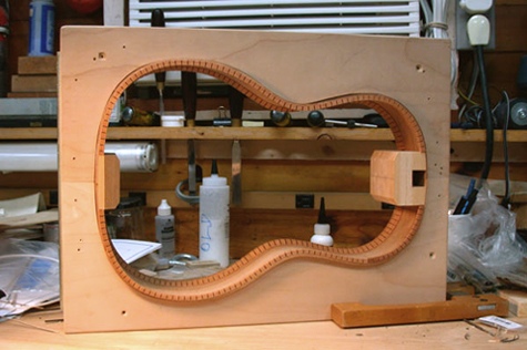

OK, here's some pics.
The guitar is a steel string, Terz size 5 in koa from Doug Kleist at Blue Spirit. The blocks and linings look huge since the lower bout is only 11-1/4".

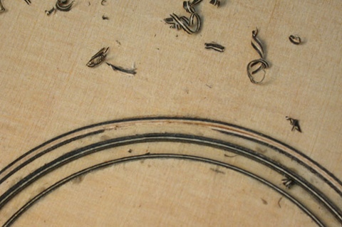

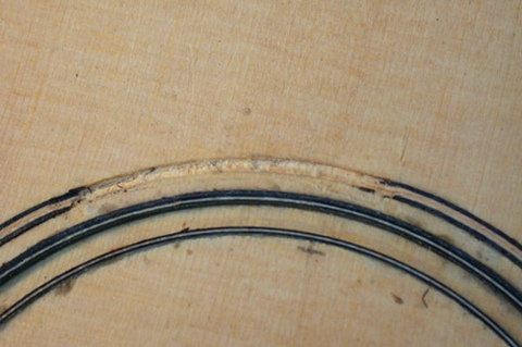

I took one step forward and one back on the rosette, it being my first. I didn't get a couple inches of one ring seated at all, so when I levelled it, I ran out of inlay. I dug out the channel by hand and spliced in the missing inlay last night. We shall see.

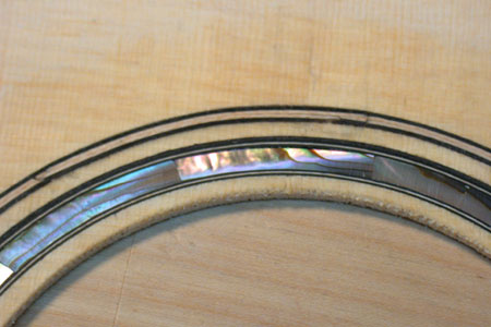

Well, I spliced in the new rosette ring, got the ab in. Looks OK to me for the kids' guitar. The joint on the left will be hidden by the just-now-revised pickguard location (funny how those spontaneous revisions just pop up), and the one on the right will be under the strings. Whew! Squeaked by that time, I think.

Excellent save on the rosette. I tried that once and ruined the whole guitar. You know, ruin the top, try to take the top off and crack the side, etc. etc. So you did really well.
